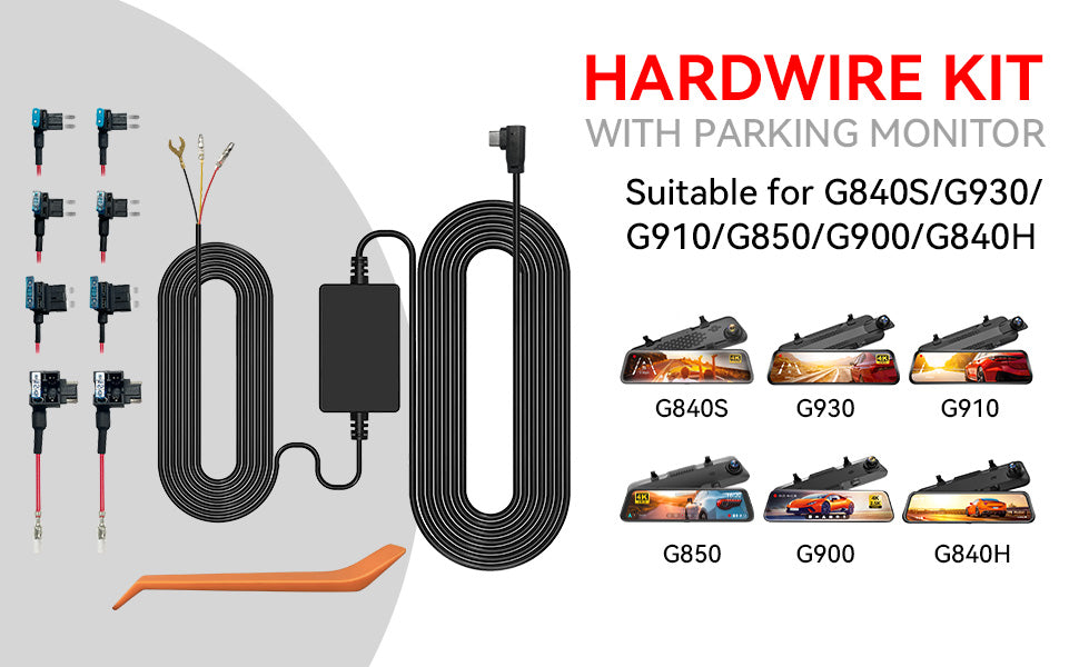

  1. Start by turning off your vehicle's engine and disconnecting the negative terminal of the battery. This is an important safety precaution to avoid any electrical shocks or short circuits during the installation process.
  2. Identify a suitable fuse to tap into for powering your dashcam. Remember to choose a fuse that is powered when the ignition is turned on and matches the amperage rating of the fuse tap. Once the power is safely disconnected, locate the appropriate fuse box and identify the correct power source for your hardwire kit. The Switched ACC Slot (Red Wire / ACC) should only provide power when the ignition key is turned to the “Accessory” position, ensuring that your dashcam receives power only when the vehicle is switched on.[4] Selecting the correct ACC fuse location is essential for proper installation and helps prevent unnecessary battery drain.
  3. Use the trim removal tools to carefully remove any panels or trim pieces necessary to access the fuse box and the area where you plan to mount your dashcam.
  4. Locate an appropriate grounding point near the fuse box. Look for a metal bolt or screw that is securely attached to the vehicle's chassis. Clean the grounding point using sandpaper or a wire brush to ensure a solid electrical connection.
  5. Connect the red wire from the hardwire kit to the ACC fuse. Use a fuse tap and connector provided with the hardwire kit for a secure connection. Ensure the connection is tight and insulated using electrical tape. Attach the yellow wire from the hardwire kit to a fuse terminal that has constant power. Utilize a fuse tap or adapter to facilitate this connection. This ensures the dash cam receives power continuously, even when the ignition is switched off.
  6. Connect the black wire from the hardwire kit to the grounding point you identified in step 4. Again, use a connector provided with the hardwire kit and ensure a secure and insulated connection.
  7. Route the wiring from the fuse box to the area where you plan to mount your dashcam. Use zip ties to secure the wiring and prevent any interference with vehicle controls.
  8. Connect the hardwire kit's connector to the dashcam's power input. Ensure a secure connection and use electrical tape to insulate the connection.
  9. Double-check all the connections, ensuring they are secure and properly insulated. Inspect the wiring for any signs of damage or exposed wires.
  10. Reconnect the negative terminal of the battery and turn on the ignition to test the dashcam's functionality. If everything is properly connected, your dashcam should power on and start recording when the ignition is turned on.
